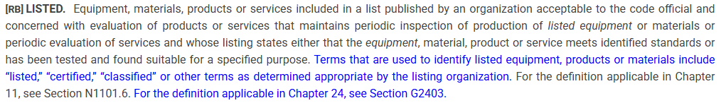

Ok here is a big one from the 2024 IRC invoking “LISTED” equipment. Chapter 11 is Energy Efficiency and Chapter 24 is Fuel Gas so I think we are good there. Seems like its open to interpretation. Anyone ready to “list” something? Maybe we could have an independent “listing” of defined configurations of equipment:
