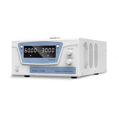

you can use a DC Power Supply like that for S19 Pro for example.
it’s not smaller but can power one hashboard if you have 13,5-14 Volt ≥ 90–100 A PowerSupply

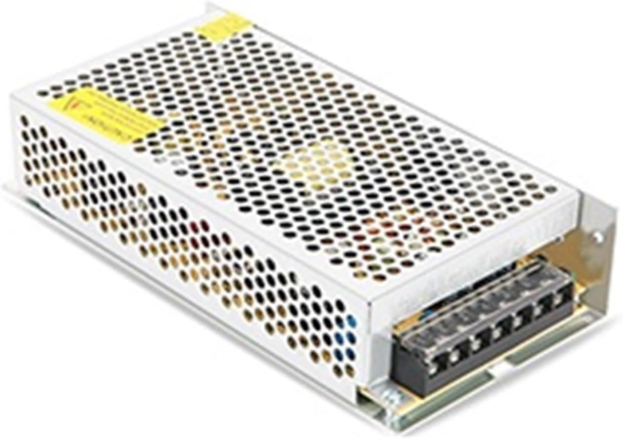

or something like this which is also smaller:
cheers
