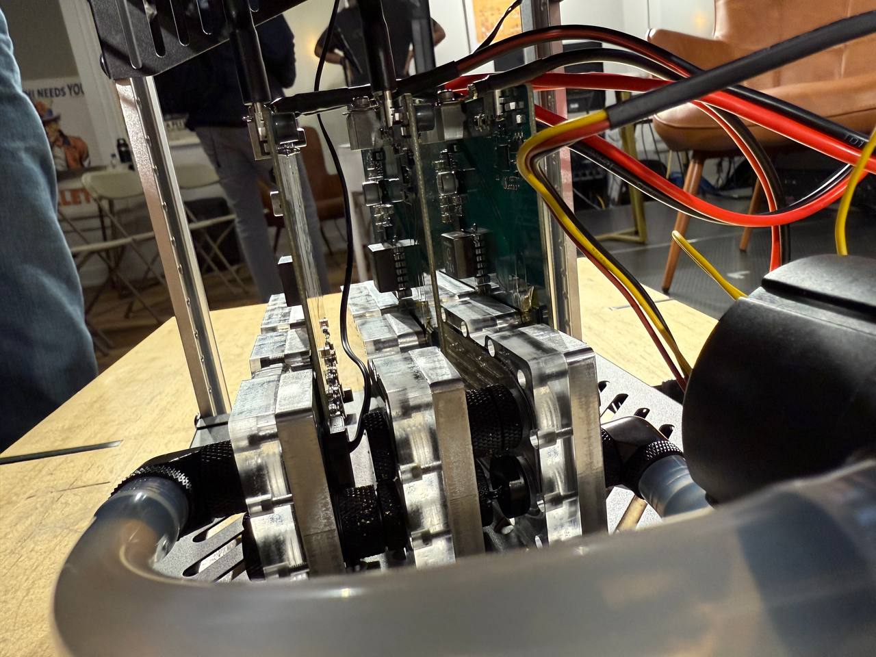

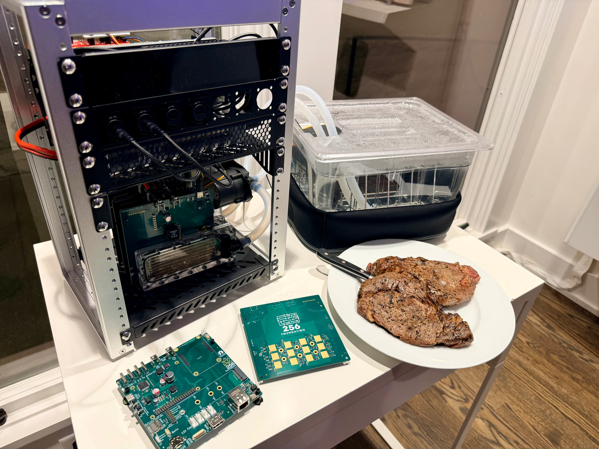

Hey y’all, I just wanted to follow up and show everyone here what became of this. We demonstrated the following at the 256F Telehash and NEMS’26 at Bitcoin Park in late January:
That’s the full 256 Foundation open-source mining stack demonstrating a heat-reuse application—a sous vide cooker. Or with my Heatpunk hat on, maybe I should say: it’s a sous vide cooker that co-produces bitcoin and freedom for all of humanity. Plus the steak was tasty.
Check out Schnitzel’s X thread for some more pictures and details.
We’ll be bringing this to the Heatpunk Summit in a couple of weeks. If you’re there, come see it for yourself!

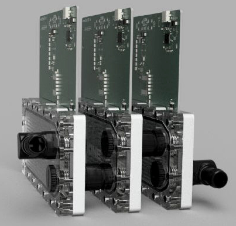

A big shout-out to Ryan Ramminger from http://cryobytelabs.com for coming up with a dope water block design, producing several himself at the last minute, and helping with pumps and tubing as well. Check these things out! He had the brilliant idea to have ports on both sides of the water block, and extend the blocks off the edge of the board, so we could stack together three in series. It turned out so well. Render and reality:
My mouth started watering when I saw the cooked steak on the plate. Is this project going to be at the Summit?
Indeed, it will be at the Heat Punk Summit next week.
