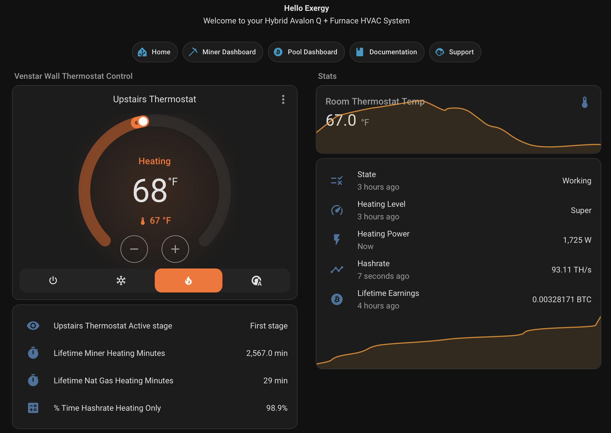

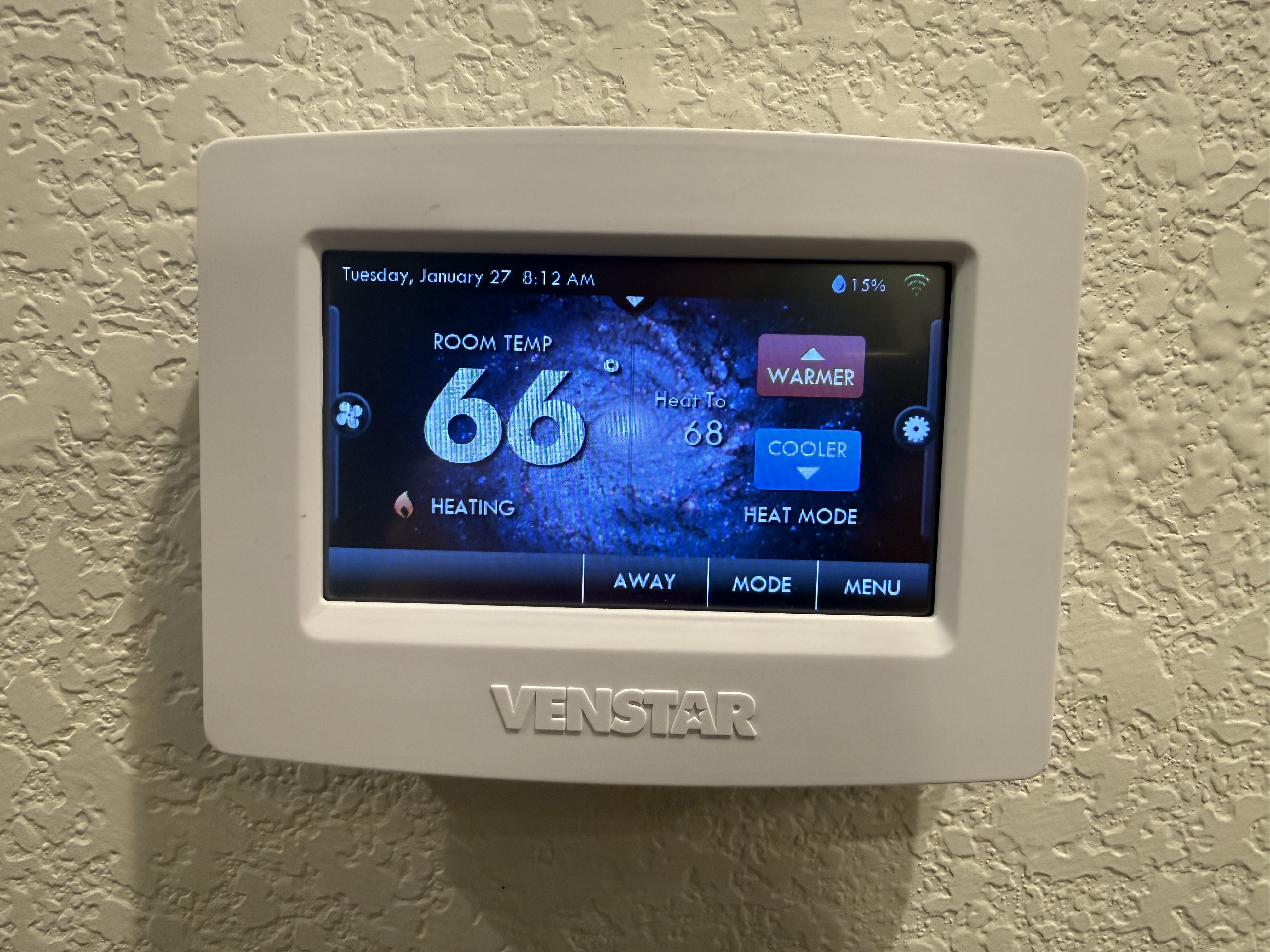

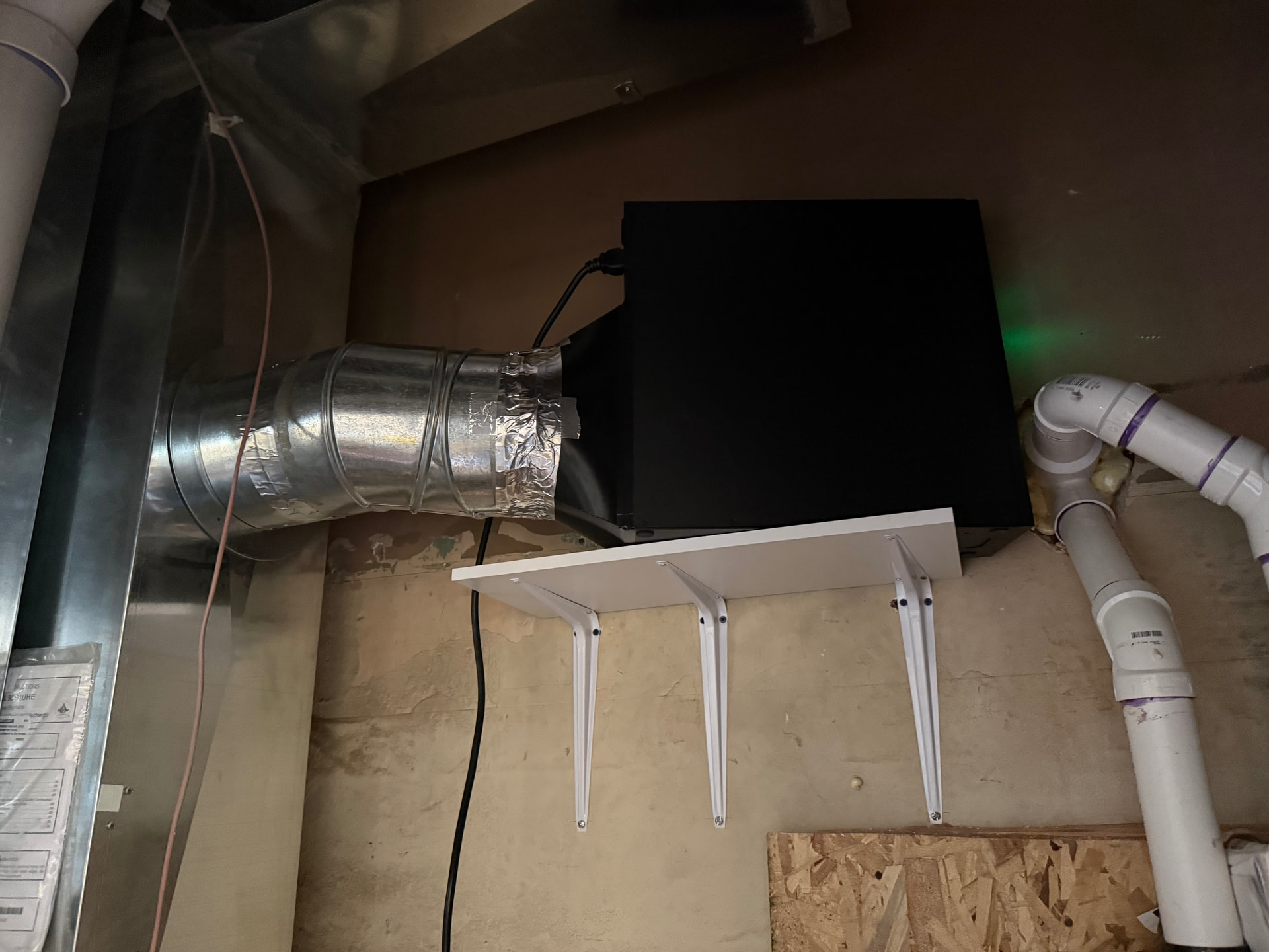

Wirelessly connected our Canaan Avalon Q to “Stage 1” of our Venstar T7900 wall thermostat via Home Assistant (via @Exergy integration). Thermostat “Stage 2” has physical wire to furnace.
Logic:
When heat is called, turn on miner + circulation fan. If can’t hit desired room temp in 15 min → turn on gas flame for help.
Might tweak these parameters for performance sake.
Result:
Our upstairs HVAC system has earned > $300 of BTC, and kept our space warm with 99% of heating time from the miner. Only 1% of the time has the gas kicked on to help.
Takeaway:
  • Cheaper Heat (solar + cheap power + btc rev)
  • Less Emissions (gas rarely runs)
  • Seamless integration (control off wall thermostat)
Cost:
  • $1900 Bitcoin Miner
  • $200 Home Assistant raspberry pi setup
  • $200 Thermostat with local API endpoints
  • $50 of HVAC and mounting materials
