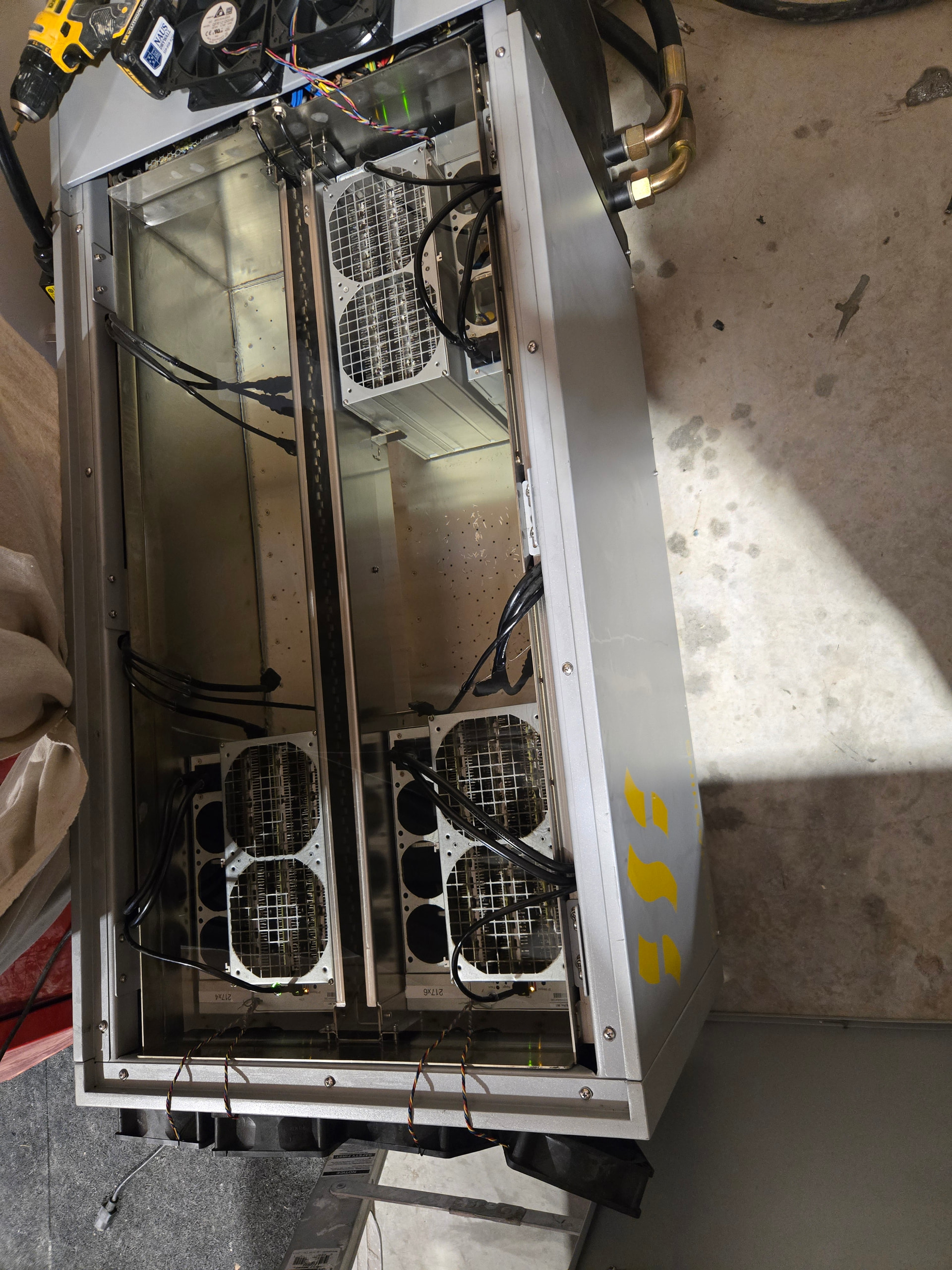

Is that tank of yours the 6 machine tank?
@Cody , yes I got a 6 machine tank,

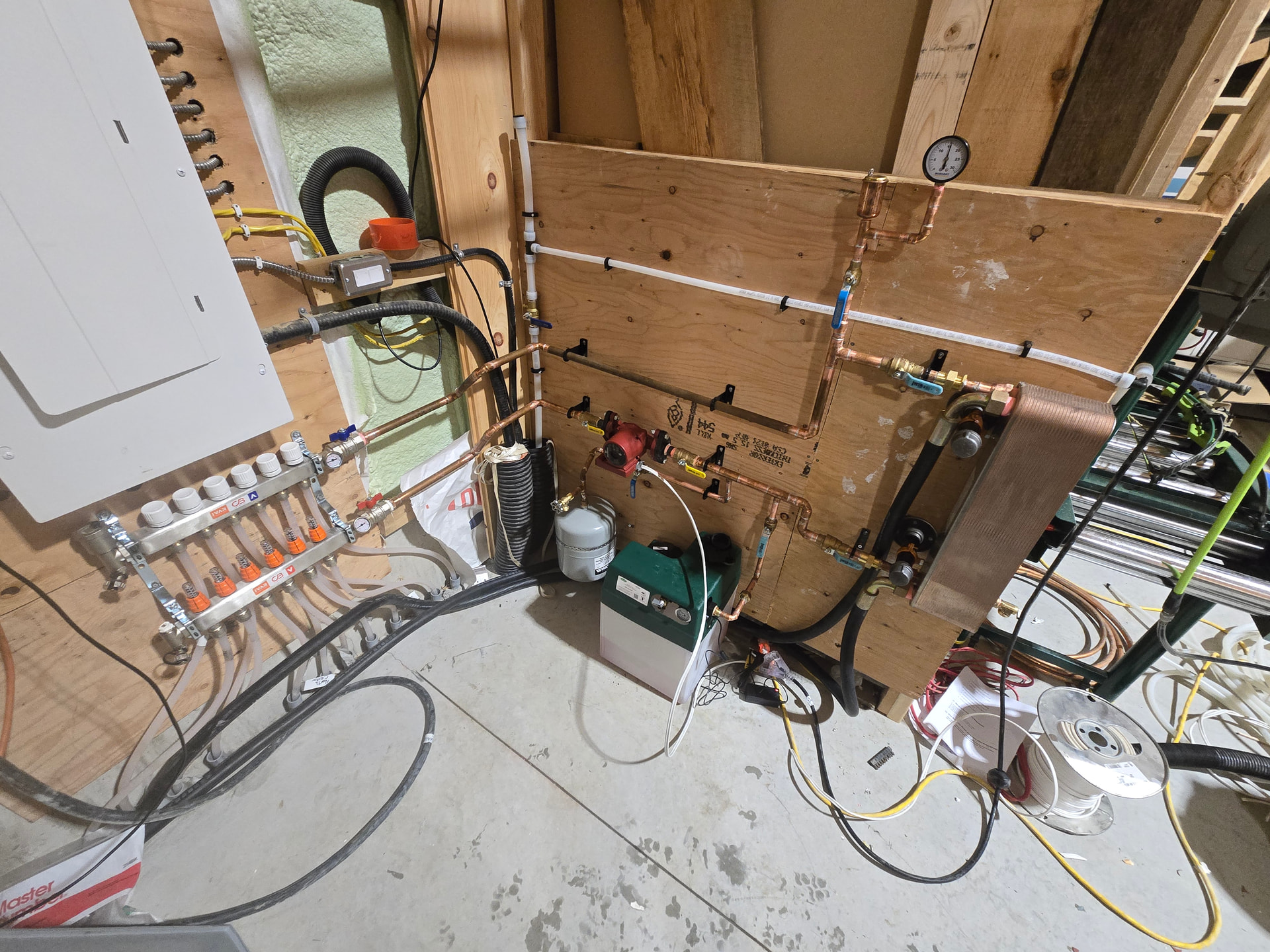

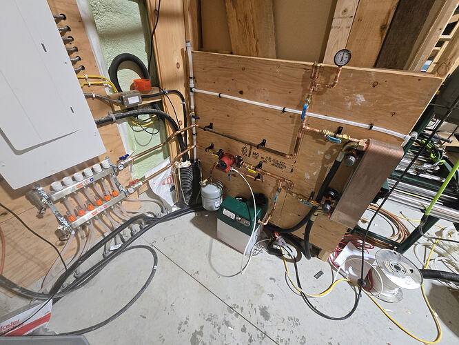

Okay, three s19 J Pros immersed in Oil so far and they are crushing it. 34x60 shop slabs at 20 indoor temperatures at 17 and outdoor is minus 17. Just gave them a clean out with an air compressor followed by isopropyl alcohol.
Any idea what the btu load is? It looks like you have 6 loops of 1/2” pex (I’m guessing less than 300’ per loop) or is there more to the hydronic side that we can’t see? Also what size Heat Exchanger is that?
Your solder work is impeccable. I love how you supported the heat exchanger! I have a Fog Hashing C2 package with a heat exchanger, cooling fan and many gallons of their proprietary oil. Everything still in boxes. Haven’t had time to get it going. I get really excited seeing this. Well done!
