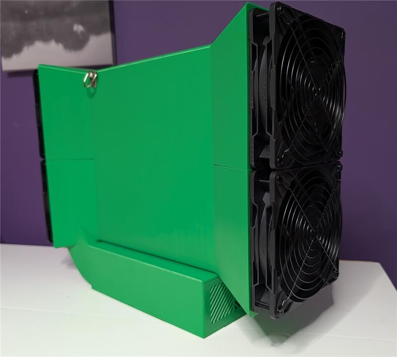

Those who saw its predecessor at UnderMine will immediately recognize the genetics. She’s grown a bit and cleaned up since then - now running 140mm fans, an even cleaner overall aesthetic, and shaved off the unnecessary show-off additions she had for UnderMine.
What is the Fornax Heater?

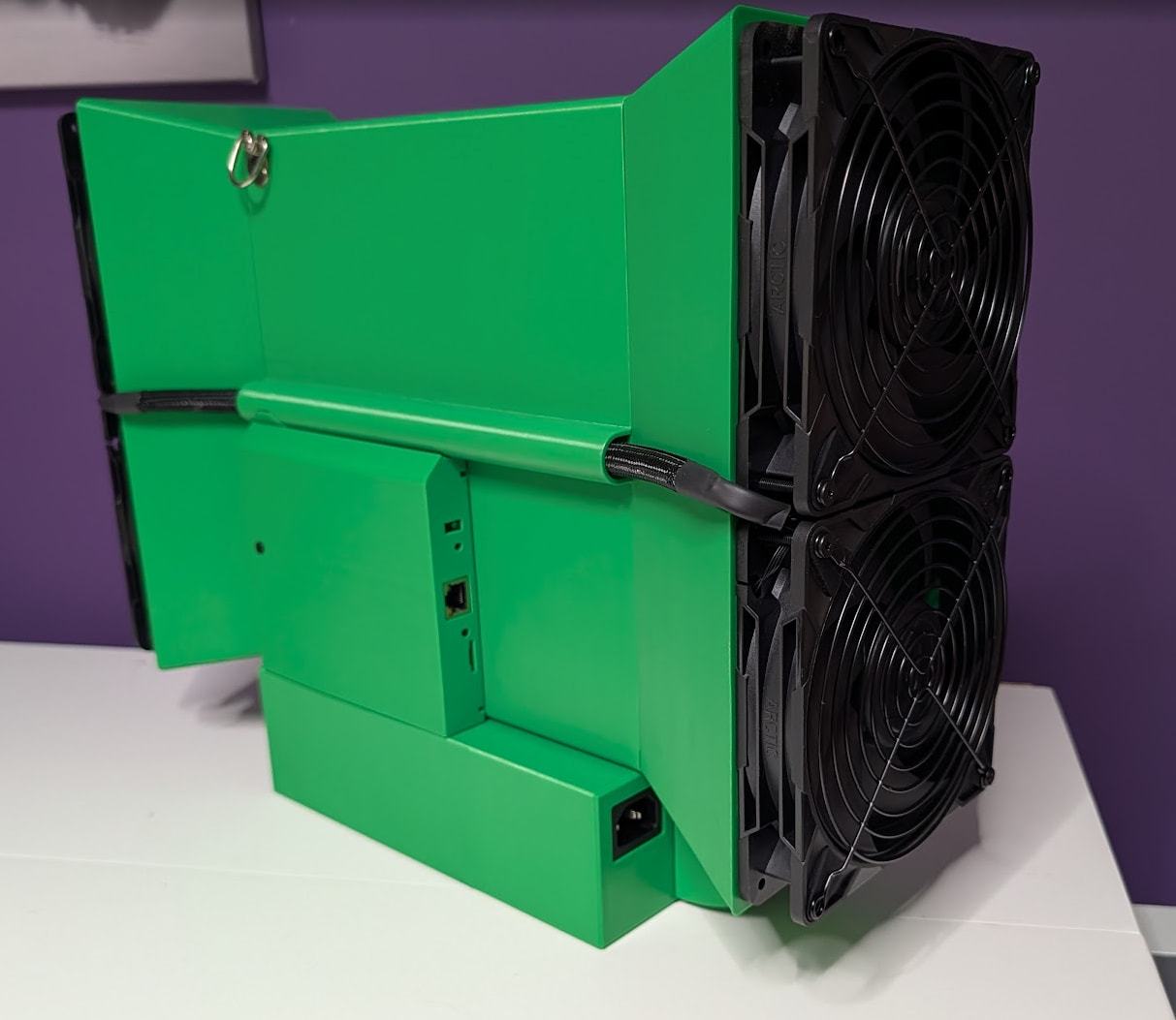

A rethought and redesigned “singleboard” heater/miner built on an APW3++ PSU and S19/21 hashboard/control board combo. The hashboard is inverted compared to other designs to allow the PSU to be bottom-mounted and connected via short bus bars rather than bulky power cables. It utilizes a optional direct-feed duct from the rear fan shroud into the PSU, allowing the often noisy PSU fan to be fully removed. With the recommended Arctic P14 Pro fans it runs near-silent at heat outputs up to 600w and audible-but-inoffensive at higher speeds. (Audible tone sounds like a conventional residential room fan than the stock miner fans do at any speed.)
Why is the Fornax Heater?
Simple: I like DIY and I like being married.
Yes, there are more-attractive heater/miners out there. But I can’t 3D print them. They’re just not accessible to the average DIY’er and most Heatpunks aren’t quite the “off-the-shelf” crowd. They’re practically giving away S19k’s these days, so it seems a pity for them to just go to e-waste, or end up in some heater config that has to hide from company under wife’s orders. This has spouse-approval for living room use when company is over and anyone with a 256x256x256mm build volume printer can make one for themselves. (Spouse approval not guaranteed, restrictions may apply, not liable for marital strife.)

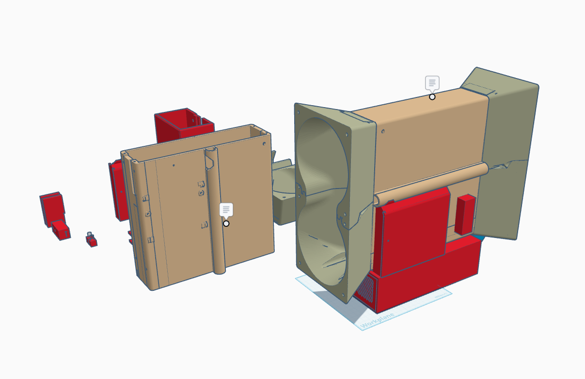

If this is what I think it is and it’s still being done in TinkerCAD. That’s nuts. Bravo!
Yeah, TinkerCAD does NOT like me. But it still works.
The rear duct into the PSU has some parts that I had AI help me build using JSCAD. Then I imported them into TinkerCAD. (Couldn’t get a radius’d square torus in TinkerCAD easily at the size/shape I needed.)

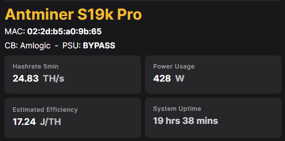

I’m blown away with how efficient the Fornax is. Thanks for giving us one to play with! I’m having a great time with it.
