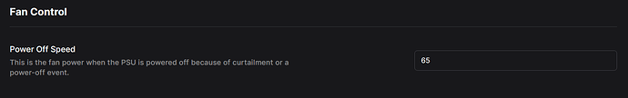

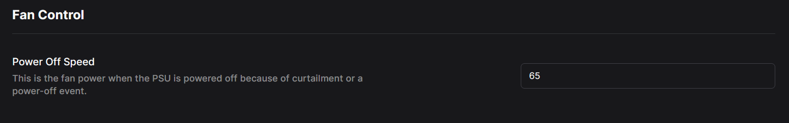

Here’s a helpful fan setting I found in LuxOS (Settings Tab > Advanced Settings - scroll down):
Adjusting this can help your miner cool down when it’s powering off or in sleep mode:
power_off_speed-Optional. A 0-100 value that defines the fan speed when miner goes in power-off.
Make sure the power off speed is set to 50% (or higher?), the default setting of 20% could overheat the miner.
