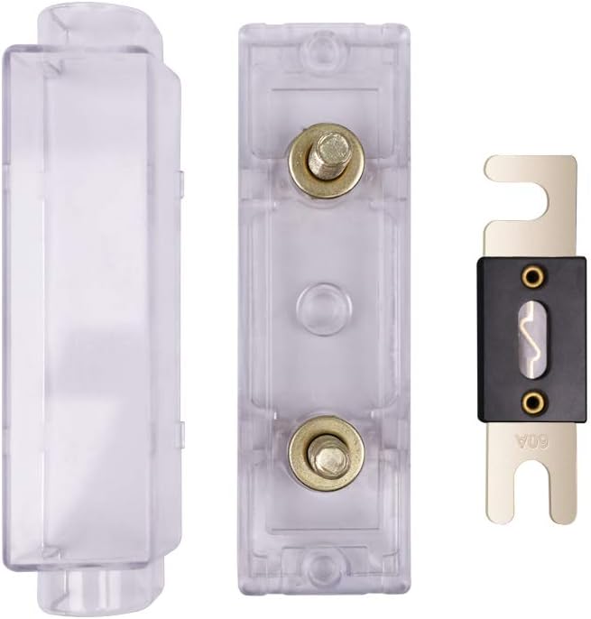

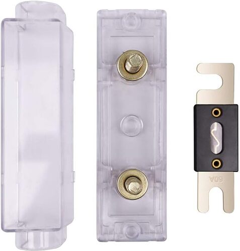

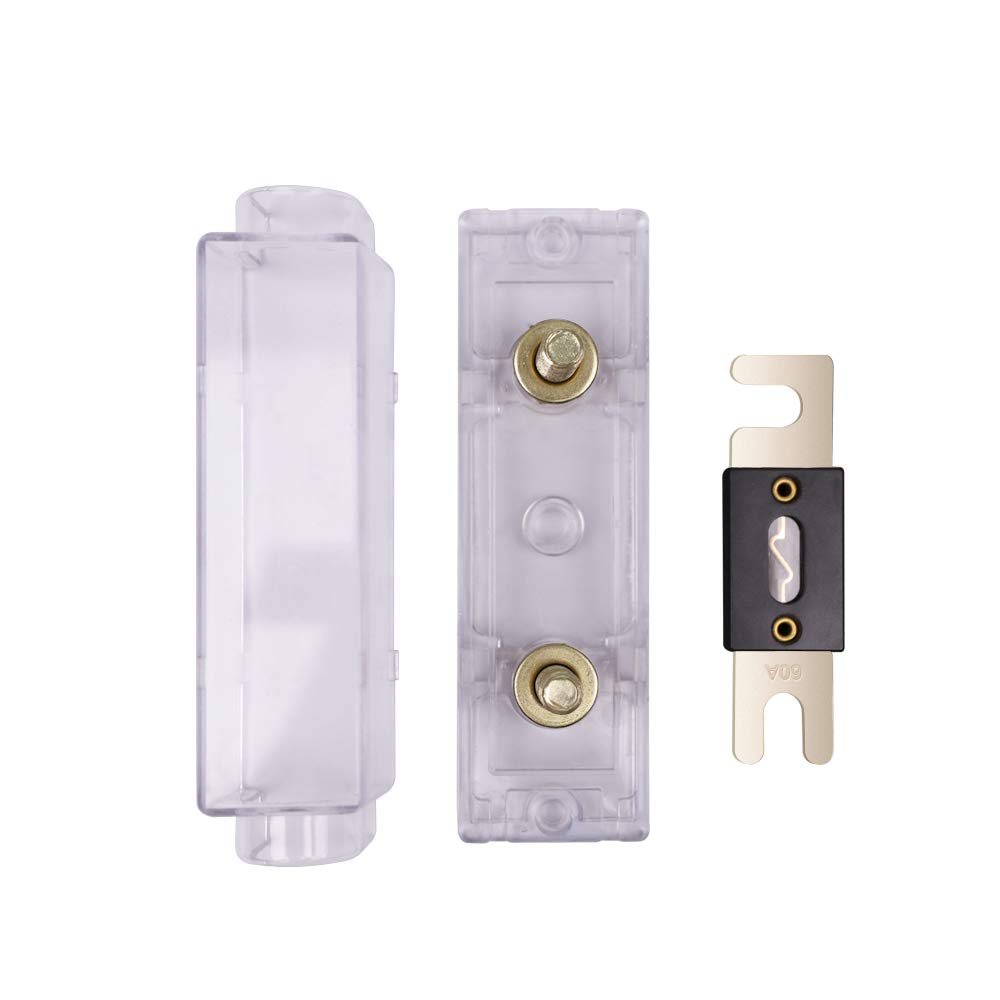

TLDR: Maybe these should have fuses because of the possibility of the user overclocking them?
I think this is the wrong size fuse for 8gauge, but you get the idea
