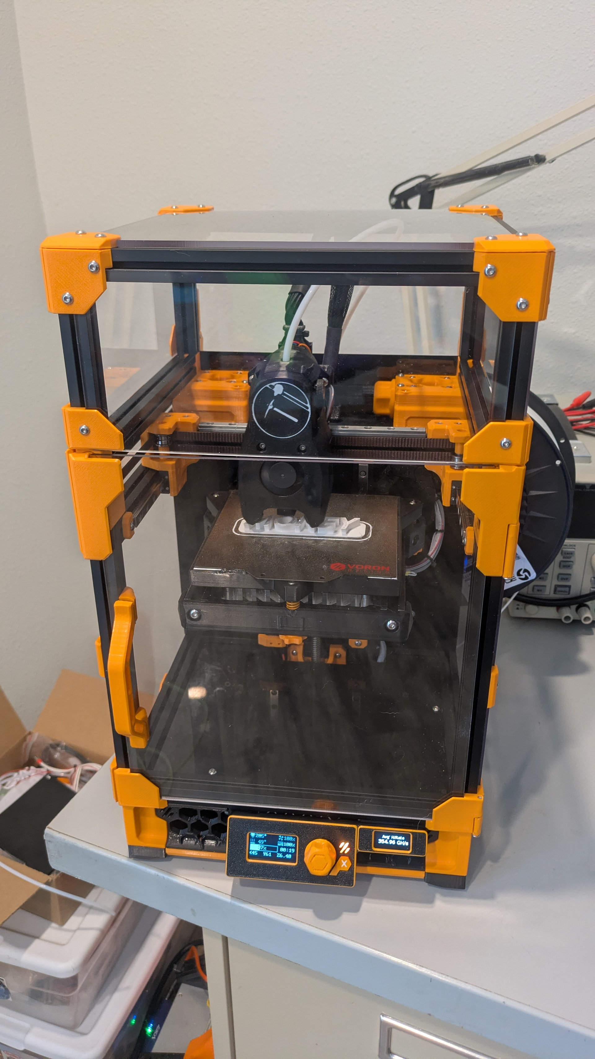

Hey everyone, I’ve got my prototype up and running and wanted to stir up a little buzz before I bring it to the Heatpunk Summit.
This build uses a hashboard from a GekkoScience coffee warmer (4x BM1362AK). I designed the bed “heatsink,” did the hardware integration, and wrote the comms script that lets the 3D printer firmware (Klipper) set and control miner temperatures. I’ve also got an onboard hotspot so the whole demo can stay mobile.
Side idea: I might print a few Bitaxe stands on-site while it’s running, if anyone’s interested in a hash-powered “made while it mines” stand.
Right now I’m still working on pushing temperatures higher. It’s topping out just under 60 C at the moment and it’s slow getting there, so this will be a PLA-only demo until I’m willing to risk breaking something.
