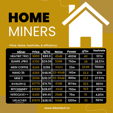

Food for thought:
This would put the Maxi at about 38.43 $/TH, but it also produces more heat than a Mini 3 (1200W vs 850W). Mini 3 can be incorporated via API into other systems while the Heatbit machines cannot.
Altair sells Bitchimneys (single boards) and Urlachers (120V versions of S19 models).
Thanks, this helps a lot. @Rowdy mentioned these S19kpro Slims that would probably be great but are out of stock :(.
One thing that drives me crazy about ALL of these models is the noise! Even HeatBit is 45db. When I used to heat my house with an s9 rocket miner i was always shooting for <30db. 45db is pretty noisy. Maybe this is where the Cryobyte single board machines could shine?
I have two Mini 3s running at my house and they’re very quiet, even in Super mode. In Eco mode, you can hardly tell they’re running. I get the occasional rattle noise when in Mining/Super mode when the fan ramps up. Wife approved!
The mini 3 would be my first choice. I’d rather build though. I’ve built 5 heaters for the price of the mini 3 and I have spare parts :grin:. The mini 3 seems like the best option, for purchasing a heater. They are really nice.
It’s important to note that the Bitchimney also comes in a 19k variant, which is a much better deal.
Assuming “Normal” mode–like in the graphic above based on the S21 variant…
$850 for 31TH @ 750W ($27.41/TH - 24J/TH)
Also, getting a 19k board down to 22J/TH with LuxOS is quite doable.
My concern with the BitChimney is the noise. 49db is pretty high. I don’t think I’ve seen one running. Do you have one?
