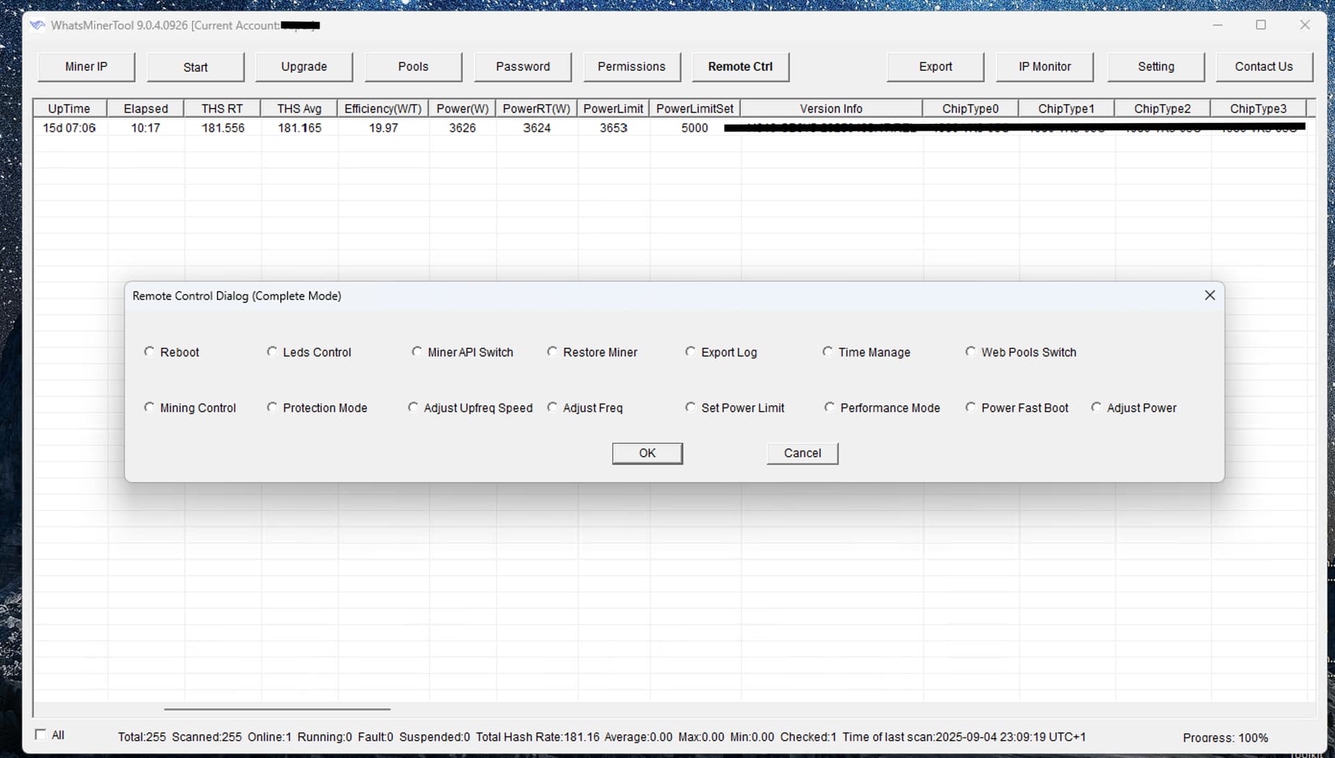

you can adjust power (not really dynamic) over the whatsminer windows tool.
there is an option to lower the power limit by percentage. Like a own Power Modus beside Low/Normal/High. It needs some time to readjust and complete the upfreq. But currently not running stable mostly more power usage and less Terahash sadly.

Can you post a screenshot of the whatsminer tool function where this is possible? I’m pretty confident our firmware / tool combo does not have this functionality. That’s what drives me crazy about these OEM miners. They don’t document anything.

Just use WhatsMiner Tool here you can see it

this is the desktop windows software from whatsminer (whatsminer tool) you can control it while scanning the network through ip, find the ip from the M64 than use Remote Ctrl.
There are much more options than in the Dashboard. All these Ctrl can be also pushed trough the API but it’s not necessary with this software.
our whatsminer tool doesn’t have the second row of setting options. wtf

one more info: there is a setting to change the compact mode (close) to complete mode and get all settings.
